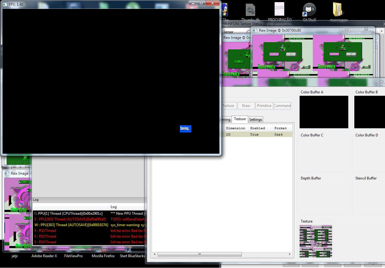

Presented an interesting behavior with the current version!
You can proceed with emulation to the main menu screen, but with a black screen and may accompany it by rsx debugger.
This error texture observed in the previous version:
[E: RSXThread] GLTexture :: Init () -> glTexImage2D: OpenGL error 0x0501
Resulted in this error now:
[E : RSXThread]: Init tex error: Bad tex format (0x84 | linear | 0x0)
Hear the sounds of button commands.
This error was displayed after choosing the game character by pressing the X button.
[W : PPU[1] Thread (CPUThread)[0x00e25010]]: cellPamf warning: cellPamfReaderGetNumberOfSpecificStreams(pSelf=0xd0010410, streamType=21)
[E : PPU[1] Thread (CPUThread)[0x00e25010]]: Exception: GetMemFromAddr(0x0)
Thereafter, no further updates in the log.
The initial opening screen with the logo of Sega continues loading normally.
log file:

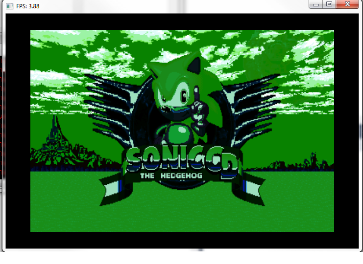

Hey
I have implemented the "CELL_GCM_TEXTURE_R5G6B5" into GLGSRender.h
case CELL_GCM_TEXTURE_R5G6B5:
            glTexImage2D(GL_TEXTURE_2D, 0, GL_RGBA, tex.GetWidth(), tex.GetHeight(), 0, GL_RGB, GL_UNSIGNED_SHORT_5_6_5, pixels);
            checkForGlError("GLTexture::Init() -> glTexImage2D");
            break;
Intro is loading ... than the Main Screen appear ... but it has strange colors
when implementing the
            //glTexParameteri(GL_TEXTURE_2D, GL_TEXTURE_SWIZZLE_A, GL_ONE);
            break;
it gaves me a very strange picutre
can you add this code on github?
(05-14-2014, 02:30 PM)element Wrote: when implementing the
            break;
If the game didn't display that before your code addition, then please make a pull request! It looks completely fine, just some minor color format issue, trivial probably.
wrong colors probably mean that color format is wrong...
#20
Yeah, no red and probably green instead of blue.
